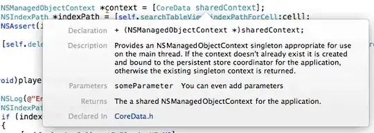

For those who did not watch the latest keynote: With Xcode 5 this feature will be built in. It is already available in the current developer preview (called quick help, like announced here).
Xcode 5 now has built-in support for DOxygen style comments. So, you can comment your methods like this:
* Provides an NSManagedObjectContext singleton appropriate for use on the main
* thread. If the context doesn't already exist it is created and bound to the
* persistent store coordinator for the application, otherwise the existing
* singleton contextis returned.
* \param someParameter You can even add parameters
* \returns The a shared NSManagedObjectContext for the application.
+ (NSManagedObjectContext *)sharedContext;
