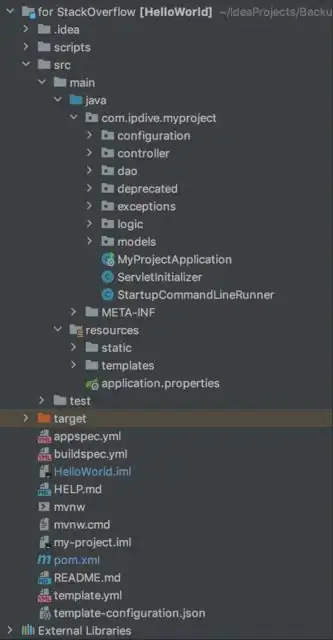

I realize that you indicated that previously you tried to use your Spring Boot project with some modifications without success, but I think it could be actually a possibility to successfully deploy your application on AWS CodeStar, and it will be my advice.
I also realized that in your screenshot you included several of the required artifacts and classes, but please, double check that you followed these steps when you deployed your application to AWS CodeStar.
Let's start with a pristine version of your Spring Boot project running locally, without any modification, and then, perform the following changes.
First, as indicated in the GitHub link you shared, be sure that you include the following files in your project. They are required for the deployment infrastructure of AWS:
