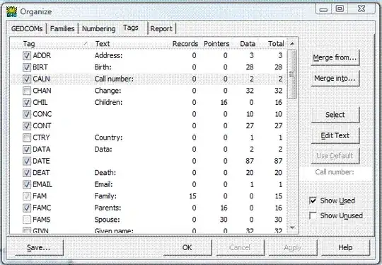

In my Delphi 2009 application, I have this window:
It has a TPageControl that has a TTabSheet on it as well as buttons at the bottom that operate on all sheets.
On the left of the TTabSheet is a TElXTree (a tree/grid component by LMD) and on the right of the TTabSheet is a TPanel containing buttons specific to just this sheet.
When I have a row selected in the TElXTree, and I click on any button in either set of buttons, the buttons all work fine.
Now within the TElXTree, the column labelled "Text" is editable with an Inplace-Editor supplied with TElXtree. When I click on the Text, it goes into edit mode.
When in edit mode, when I click anywhere in the TElXTree (e.g. on the checkbox), it will exit the editor AND process the command (i.e. check or uncheck the checkbox). However, when in edit mode, when I click on any button in either set of buttons, it will simply exit the inplace-editor and NOT process the button. I then have to click on the button again to process that button.
Is there something simple that I am not doing or not understanding here that would allow me to click on one of those buttons and allow it to both exit my inplace editor AND process the button?
