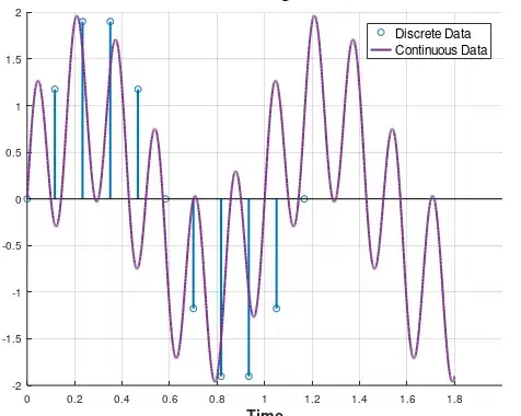

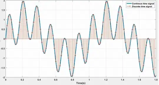

Apologies if my title is vague but I created a sine wave combined from 2 previous sampling wave graphs (Nyquist frequencies). I also tried to create a stem graph with the intent of the output looking like the sine wave was getting discretely sampled, looking like this:
I did manage to successfully get the wave, but as for the rest of it ended up looking like this:
This is my code:

I thought that, like the sine wave, I could just simply add the values to create the variable "nqsignal", unfortunately not working and making those inaccurate outputs.
