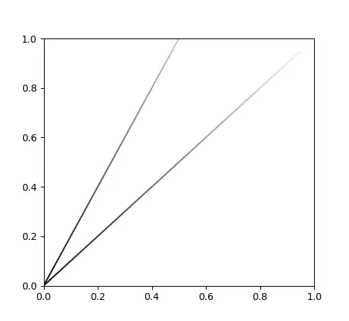

I am trying to color lines with a colormap so that the gradient color indicates the length of the line. My current program colors lines, depending on where they are on the x-axis.
All variables ending with _2 belong to the diagonal line.

As you can see, the diagonal line is plotted in the full colormap (color regions 0 to 1). It has a length of 1.41 (square root of x=1 and y=1). The upper line has a length of 1.12 (x=0.5, y=1). The upper line is about 0.8 times as long as the diagonal line. How would I use the colormap to color the line in region 0 to 0.8 instead of (as of now) 0 to 0.5?
Edit:
Thanks to tmdavison I was able to work it out. This code colors the line, depending on its length:
