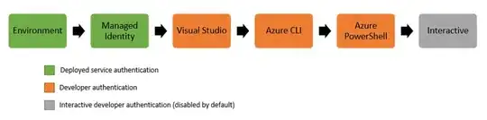

In the client ASP.NET Core webapi app, I've added the Azure.Identity nuget package, and am getting a token like this...
var tokenRequestContext = new TokenRequestContext(new[] {scope});
token = await new DefaultAzureCredential().GetTokenAsync(tokenRequestContext, cancellationToken);

When running this locally and in Azure, I'm setting the AZURE_CLIENT_ID, AZURE_CLIENT_SECRET, AZURE_TENANT_ID environment variables to the same value. I don't understand why it would work differently locally than in Azure, given these environment variables are the same.
Note that my intention is to use a Managed Service Identity instead of setting those environment variables. But for the time being, by using those environment variables both locally and in Azure - both should be using the same "ClientSecretCredential" authentication - so I'd expect the same results.
