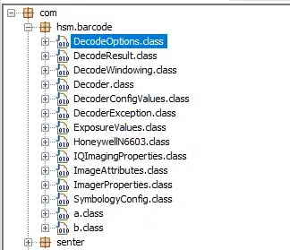

Looking in the jars using JD-GUI as suggested in the Microsoft Docs I can see the problem is that both of the jars have a com.hsm.barcode package:

<attr path="/api/package[@name='com.hsm.barcode']/class[@name='DecodeOptions']" name="name">DecodeOptions2</attr>. When I do this, in reflector I can see that the class name has indeed changed, but I still get the build error when building the Xamarin.Android project - Renaming the namespace in one of the projects:
<attr path="/api/package[@name='com.hsm.barcode']" name="name">com.hsm.barcode2</attr>. Again, I can see the updated namespace in reflector but still I get the same "Program type already present" error when building the Xamarin.Android project - Similarly I have tried removing both the namespace and the duplicate classes using
remove-nodebut seen similar results
