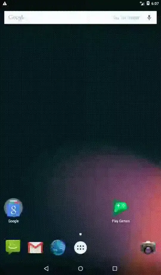

A little test conducted
A test involved three different sizes ImageViews 100x100, 200x200 and 300x300 DP respectively. Glide was tasked to load an 8K image into 200x200dp ImageView. Then after a short delay load the same image into the 100x100dp ImageView and after another delay into 300x300dp ImageView.
The test shows that the original image was cached due to instant loading speed into 300x300dp ImageView.
Note: Toast messages pop-up right before the image loading starts.
Video proof:
(If the video link is broken try this link).
