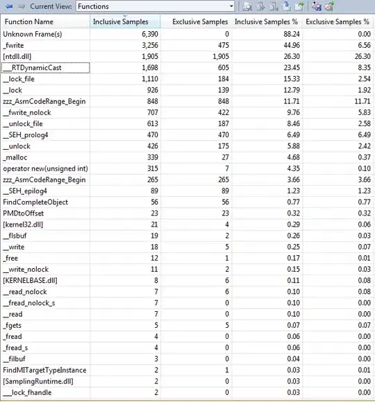

I ran my app twice (in the VS ide). The first time it took 33seconds. I decommented obj.save which calls a lot of code and it took 87seconds. Thats some slow serialization code! I suspect two problems. The first is i do the below
template<class T> void Save_IntX(ostream& o, T v){ o.write((char*)&v,sizeof(T)); }
I call this templates hundreds of thousands of times (well maybe not that much). Does each .write() use a lock that may be slowing it down? maybe i can use a memory steam which doesnt require a lock and dump that instead? Which ostream may i use that doesnt lock and perhaps depends that its only used in a single thread?
The other suspected problem is i use dynamic_cast a lot. But i am unsure if i can work around this.
Here is a quick profiling session after converting it to use fopen instead of ostream. I wonder why i dont see the majority of my functions in this list but as you can see write is still taking the longest. Note: i just realize my output file is half a gig. oops. Maybe that is why.
