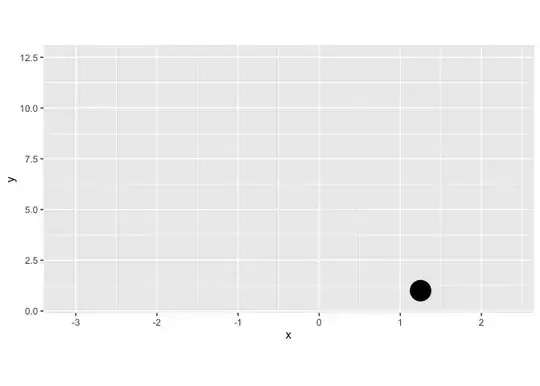

However, the gganimate version does not (see below). It only puts the dots on the x-axis and doesn't stack them.
plot+
transition_reveal(along=index)
