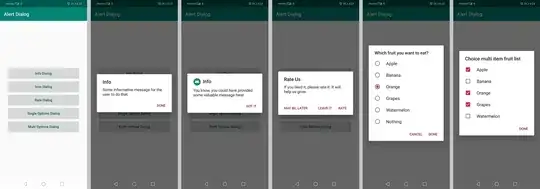

Alert Dialog
alert dialog with a single button.
alert dialog with an icon.
alert dialog with three-button.
alert dialog with a choice option, radio button.
alert dialog with the multi-choice option, checkbox button.

/*Display information dialog*/
private void infoDialog() {
AlertDialog.Builder dialogBuilder = new AlertDialog.Builder(this);
dialogBuilder.setTitle("Info");
dialogBuilder.setMessage("Some informative message for the user to do that.");
dialogBuilder.setPositiveButton("Done", new DialogInterface.OnClickListener() {
@Override
public void onClick(DialogInterface dialog, int which) {
dialog.dismiss();
dialogBuilder.create().show();
/*Display rating dialog*/
private void ratingDialog() {
dialogBuilder.setTitle("Rate Us");
dialogBuilder.setMessage("If you liked it, please rate it. It will help us grow.");
dialogBuilder.setPositiveButton("Rate", new DialogInterface.OnClickListener() {
@Override
dialog.dismiss();
dialogBuilder.setNegativeButton("Leave it", new DialogInterface.OnClickListener() {
@Override
dialog.dismiss();
dialogBuilder.setNeutralButton("May be, later", new DialogInterface.OnClickListener() {
@Override
dialog.dismiss();
/*Dialog with icons*/
private void iconDialog() {
dialogBuilder.setIcon(R.mipmap.ic_launcher_round);
dialogBuilder.setMessage("You know, you could have provided some valuable message here!");
dialogBuilder.setPositiveButton("Got it", new DialogInterface.OnClickListener() {
@Override
dialog.dismiss();
/*Dialog to select single option*/
private void SingleSelectionDialog() {
fruitNames = getResources().getStringArray(R.array.fruit_name);
AlertDialog.Builder dialogBuilder = new AlertDialog.Builder(MainActivity.this);
dialogBuilder.setTitle("Which fruit you want to eat?");
dialogBuilder.setSingleChoiceItems(fruitNames, -1, new DialogInterface.OnClickListener() {
@Override
public void onClick(DialogInterface dialogInterface, int i) {
//Toast.makeText(MainActivity.this, checkedItem, Toast.LENGTH_SHORT).show();
select = fruitNames[i];
@Override
Toast.makeText(MainActivity.this, "Item selected: " + select, Toast.LENGTH_SHORT).show();
dialogBuilder.setNegativeButton("Cancel", new DialogInterface.OnClickListener() {
@Override
Toast.makeText(MainActivity.this, "Cancel", Toast.LENGTH_SHORT).show();

ArrayList<String> selectedStrings = new ArrayList<>();
for (int j = 0; j < selectedList.size(); j++) {
selectedStrings.add(items[selectedList.get(j)]);
Toast.makeText(getApplicationContext(), "Items selected: " + Arrays.toString(selectedStrings.toArray()), Toast.LENGTH_SHORT).show();
builder.show();
- 1,969
- 17
- 17
Its very simple
new AlertDialog.Builder(this).setView(input).setPositiveButton("ENTER",
{ public void onClick(DialogInterface di,int id)
output.setText(input.getText().toString());
.create().show();
In case you wish to read the full program see here: Program to take input from user using dialog and output to screen
- 33
- 1
AlertDialog alertDialog = new AlertDialog.Builder(this).create();
// Single Button
alertDialog.setTitle("Terms & condition");
alertDialog.setIcon(R.drawable.baseline_info_24);
alertDialog.setMessage("Have You read all the T & C ");
alertDialog.setButton("Yes, I have read ", (dialogInterface, i1) -> alertDialog.show());
//setButton is outdated
// Double Button
AlertDialog.Builder delDialog = new AlertDialog.Builder(ListLearn.this);
delDialog.setTitle("Delete");
delDialog.setIcon(R.drawable.baseline_delete_24);
delDialog.setMessage("Are You sure want to delete ? ");
delDialog.setPositiveButton("Yes", (dialogInterface, i16) -> Toast.makeText(ListLearn.this, "Deleted", LENGTH_LONG).show());
delDialog.setNeutralButton("No", (dialogInterface, i12) -> Toast.makeText(ListLearn.this, "Item Not deleted", LENGTH_LONG).show());
delDialog.show();
