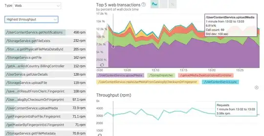

The expected result is that the browser will show the image much like you'd see from an imgur link, basically the same format as I will use to show the screenshot of the current result is the expected result.
