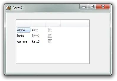

but i fail miserably in my attempt to draw a checkbox :(, can someone point me in the right direction to draw the checkbox in the listview, (the code does not draw any checkbox in the listview).
The listview is in vsReport mode and had 3 columns, i want put the checkbox in the third column. please don't suggest which use a thrid party component, i want use the TlistView control.
UPDATE 1 : thanks to the sertac recomendattion setting the DefaultDraw value now the checkboxes are shown, but the another columns looks awfull.
UPDATE 2 , following the Andreas suggestions the listview now look better, but still shown the black box;
