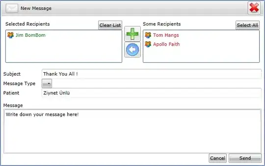

What I'm trying to do is when the single/all check box is checked, change the background and color of the div which have the H4 tag. When unchecked all checkbox within div, remove the background color and h4 color. How can I do this using jquery or jquery+javascript?
for better understanding
Thanks
