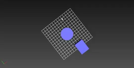

Problem with these rotation functions appears when the camera view direction becomes parallel to the up axis (z-up over here)... at that point the camera behaves in a really nasty way so I'll have glitches such as:
So my question is, how can I adjust the above code so the camera will make full rotations without the end result looking weird at certain edge points (camera axis flipping around :/)?
