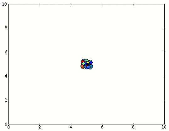

At any rate, as a pointless-but-fun example, consider the following:
import numpy as np
import cStringIO
plt.ion()
fig = plt.figure()
ax = fig.add_subplot(111)
num = 50
max_dim = 10
x = max_dim / 2 * np.ones(num)
s, c = 100 * np.random.random(num), np.random.random(num)
scat = ax.scatter(x,x,s,c)
ax.axis([0,max_dim,0,max_dim])
ax.set_autoscale_on(False)
for i in xrange(1000):
xy = np.random.random(2*num).reshape(num,2) - 0.5
offsets = scat.get_offsets() + 0.3 * xy
offsets.clip(0, max_dim, offsets)
scat.set_offsets(offsets)
scat._sizes += 30 * (np.random.random(num) - 0.5)
scat._sizes.clip(1, 300, scat._sizes)
fig.canvas.draw()
