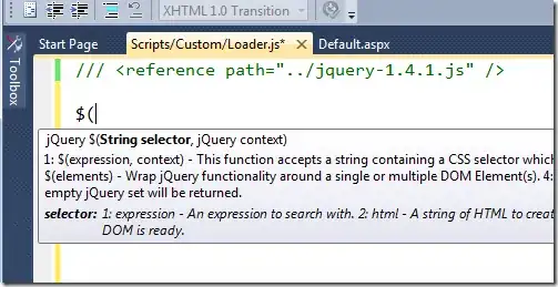

Drag the jquery file into the js file you want intellisense on like this:
Then it will work like this:

1The question is about Razor files (.cshtml, .vbthml) not JavaScript files. The `
` syntax works when you need automcomplete from one JavaScript file in another JavaScript file (.js). – Meligy Jul 20 '13 at 09:57 -
