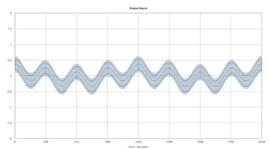

Here are some graphs from my tests:
I created a signal, which consists of three cosine waves
I used this filter function in the time domain for filtering. (It's symmetric, as it is applied to the whole output of the FFT, which also is symmetric for real input signals)
The output of the IFFT looks like this: It can be seen that low frequencies are attenuated more than frequency in the mid range.
For the overlap add/save and the windowed processing I divided the input signal into 8 chunks of 256 samples. After reassembling them they look like that. (sample 490 - 540)
It can be seen that the overlap add/save processes differ from the windowed version at the point where chunks are put together (sample 511). This is the error which leads to different results when comparing windowed process and overlap add/save. The windowed process is closer to the one processed in one big junk.
However, I have no idea why they are there or if they shouldn't be there at all.
