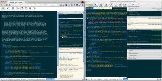

Code is working as I expected problem is that should also works for multiple users. I guess the max active users which will call pull operation will max 1000. So every call of pull take max 5 seconds as I set in DefferedResult but it isn't.
As you can see in image, if I immediately call rest of pull operation from my javascript client multiple times you can see that tasks will executed sequentially instead of simultaneously. Tasks which I fired as last take about 25 seconds, but I need that when 1000 users execute at same time pull operation, that operation should take max 5 seconds + latency.
How to configure my app to execute these tasks simultaneously and ensure each each task will about 5 seconds or less (when another user send something to waiting user)? I tried add this configuration into property file:

I tried another form of testing and instead of browser I used jMeter. I execute 100 requests in 100 threads and here is result:
As you can see requests will be proceed by 10, and after reach 50 requests application throw exception:
