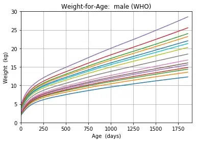

This is what I have:
# Import the WHO weight-for-age data from Excel
import pandas
import numpy as np
WHO_WFA = pandas.read_excel("PercentilesData.xlsx", sheetname="WGT_WHO")
# ... slice the dataframe and plot it
# steps omitted for brevity
# Plot with data:
plt.plot(maleAge, maleP01, maleAge, maleP1, maleAge, maleP3, maleAge, maleP5, maleAge, maleP10, maleAge, maleP15, maleAge, maleP25, maleAge, maleP50, maleAge, maleP75, maleAge, maleP85, maleAge, maleP90, maleAge, maleP95, maleAge, maleP97, maleAge, maleP99, maleAge, maleP999)
# Set up the axes/labels
plt.title('Weight-for-Age: male (WHO)')
plt.xlabel('Age (days)')
plt.ylabel('Weight (kg)')
plt.axis([0,1900,0,30])
plt.grid(True)
plt.show()
Instead, the x-axis should have ticks in 2-month increments (2,4, 6, 8, 10,12 ... to 60). I still need the data plotted using days though! So the x-axis value of 60 should be displayed as 2, 120 (days) is displayed as 4 (months), etc.

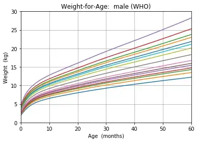

UPDATE 1: Dividing the values by month duration does result in the same curves, as long as the x-axis range is adjusted:
# month duration
mo = 30.4375
# divide age in days by month duration
plt.plot(maleAge/mo, maleP01, maleAge/mo, maleP1, maleAge/mo, maleP3, maleAge/mo, maleP5, maleAge/mo, maleP10, maleAge/mo, maleP15, maleAge/mo, maleP25, maleAge/mo, maleP50, maleAge/mo, maleP75, maleAge/mo, maleP85, maleAge/mo, maleP90, maleAge/mo, maleP95, maleAge/mo, maleP97, maleAge/mo, maleP99, maleAge/mo, maleP999)
# Adjust the maximum x value to 60 ...
plt.axis([0,60,0,30])
This produces:
The last step is how to display the axis using major ticks at every 12 months and minor ticks every 2 months.
