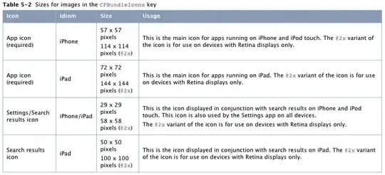

The best result belongs to michelf/php-markdown as you can see on the following image:
$ composer require michelf/php-markdown
use Michelf\MarkdownExtra;
$parser = new MarkdownExtra();
$html = $parser->transform($markdown);
echo $html;

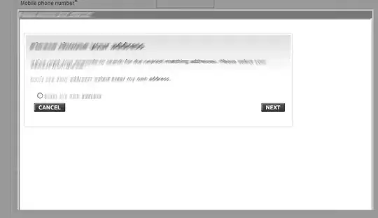

Now I'm almost at my goal.
I used:
https://github.com/sindresorhus/github-markdown-css
And now I get a result very similar to GitHub but the code is not getting highlighted (with colors) according the corresponded language (on this case: html) as you can see on the following image:
Then my QUESTION now is:
what extra step do I need to do in order to get code syntax highlight like GitHub does?. Please, check the following GitHub's output:
