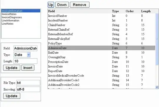

IronPython with WPF is the most productive way to design a GUI that I'm aware of. Almost all of the app pictured below is written in IronPython. Only very small parts are done in C# or C++/CLI for performance reasons.
Sure, you do miss some WPF/C# integration, but you gain much more on the productiveness side.
