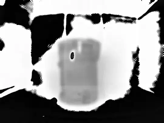

I have a box, transparent from the front and i am placing camera on the front transparent panel to capture the image of the internal, most of the time the box is empty, but suppose someone places an object inside this box, then i have to just extract this object from the image captured.
(My real aim is to recognize the object placed inside the box, but first step is to extract the object and then extract features to generate a training model, and for now i am only focusing in extracting the object from the image)
I am new to OpenCV and using it with Python and i found few OpenCV functions which can help me.
- GrabCut, this works perfectly for me, i am able to just extract the object, provided that, i mark the rectangle over the object, but as object can be anywhere inside the box so its not possible to draw the exact size rectangle of the object, and if there is a way please suggest me.
- Difference of Image, Since i have empty cavity box image and when the object is present, i can use cv2.absdiff function to calculate the difference between the image, but this doesn't work properly in most of the cases, as it uses pixel by pixel difference calculations, and due to this results are weird, plus change in light conditions also makes it difficult.
- Back Ground Subtraction, i read few post on this and it looks this is what i need, but the example i got is for video, and i didn't understand how to make it work with just two images, one empty box and another with object.
The code for back ground subtraction is as follow, even it doesn't work that much properly for short distances

Can anyone please help in this topic, and also how to modify the above code to just use the two images, when i tried i get blank images. Thanks in Advance
Sample Images from Camera are as follow: (I am using 8MP Camera that's why the image size is large, i reduced the size and then uploading it here)
