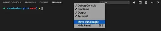

With v1.64.2 they have brought back the command View: Move Panel Right (or Left). You can put the Panel (which typically has the Terminal/Output/etc. in it) as a vertical column on the left or right side - next to the Side Bar or Side Panel if you wish.
They are working on a fix for the change wrought by v1.64, should be in Insiders v1.65 02/08/2022.
Just use the View: Move Panel Right/Left/Bottom command from the Command Palette.
[Outdated answer, see above.]
