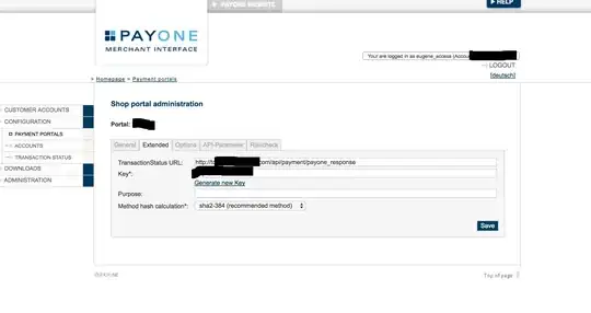

The hash method has been chosen in the web interface: https://pmi.pay1.de/merchants/?navi=portal&rc=1 (Method hash calculation*: SHA2-384 (recommended method))
