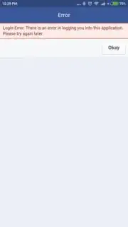

I am getting this error. When I try to sign in with facebook to my app. When I first time authentication it will correctly working. After I unistalled my application and now trying to sign in with Facebook on that I am getting this error.
Another Issue : After authenticate in device1 and try to login with facebook on device2 also same error is getting.
Solution I Found : when I remove App authentication from Facebook App Settings it is working in above scenario's but this is not an good solution how we can tell to users to do this action?

Error page
In Facebook example also having an issue : GitHub link of Facebook example
Steps to reproduce :
  1. Launch the app Login with Facebook Authenticate FB profile.
  2. Un_install the app and install again.
  3. Now try to Login with Facebook.
  4. The above error will occur. because we already authenticated so need to access fb profile. but here we facing the issue.
  5. Here already authenticated page is not showing.
  6. I am using Native FB app with the device Xiaomi Redmi Note 3

The error occurs because of invalid hash key.
We can create Hash key using the below command and update the same here under Settings-> Basic -> Android HashKeys
keytool -exportcert -alias ADD_RELEASE_KEY_ALIASE_HERE -keystore ADD_UR_KEYSTORE_PATH_HERE | openssl sha1 -binary | openssl base64
You can find the Relase Key Alias of your keystore using the below command if needed:
keytool -list -keystore ADD_UR_KEYSTORE_PATH_HERE
I have also experience an issue like by using the above HashKey the login works fine if I install the release APK directly to the device, But when I upload the APK to Play Store and install app from store then it shows the same Login failed error. The fix for this is as follows:
  1. Go to Release Management here
  2. Select Release Management → App Signing
  3. You can see SHA1 key in hex format App signing certificate.
  4. Copy the SHA1 in hex format and convert it in to base64 format, you can use this link do that without the SHA1: part of the hex.
  5. Go to Facebook developer console and add the key (after convert to base 64) in the
    settings → basic → key hashes

  • I already overridden access tracker. But not resolving my issue – Naveen Kumar M Aug 22 '16 at 05:33
  • First time I authenticated successfully. When I Uninstall and install now try to access Fb Login now AccessToken.getCurrentAccessToken() is null. Its not null in nexus devices right now issue is facing on Redmi devices and some of the samsung devices also. – Naveen Kumar M Aug 25 '16 at 11:26
I was facing the same issue. I had my keyhashes defined perfectly, was still facing the same issue. I was not able to login even for the first time.
Solution to my problem was:
  1. Go to your app's dashboard here
  2. On the left pane, under products tab, ensure that you have Facebook Login added. If not, add it there.
If all your other configurations are in place. It works perfect after that.

I was getting this error when signing in from a different account. when i signed in using developer account i recieved this error Facebook Login: "The application has disabled the Oauth client flow for Facebook integration" which was solved by enabling Client Oauth login from facebook developer account->myApp->products-> Facebook Login
I had the same problem on my Redmi Note 3. Tested on Samsung. No problems. Wonder if it is Redmi specific.

The problem for me is really with the hash key, It's not valid.
I had exactly the same problem and it was very hard to diagnose. The reason is that Facebook doesn't check the hash key at first login and it seems that the key is correct, but indeed it's not. Second, the error message is simply an idiocracy. Third is the resolution: try the following link, it helped me.
Better instructions to generate a valid hash key

I faced the same issue and I found that the hash key which I have generated to put in facebook developer console is not proper. I tried to generate hash key from different PC and it asked me to enter password for that particular keystore which was not the case in my PC. So make sure that you will asked to enter key store password while creating hash key then insert that hash key into facebook developer console.
Command to generate hash key:
keytool -exportcert -alias TYPE ALIAS HERE -keystore KEY_STORE_FILE_PATH_HERE | openssl sha1 -binary | openssl base64

I had the same problem today on my sites and then realised that I was using the old default_graph_version = v3.2. I've changed it to the latest:
default_graph_version = v4.0
Now everything works again. Give it a try.

The issue for me (at the time of writing this) was when adding hash directly in Facebook Login -> Settings page. For some strange reason it does not save it correctly.
I fixed this with going to Quickstart and adding hashes in one of the steps and hitting Save. (fix will probably be obsolete when they fix their web page)
I did not have an issue with the tool, it generated correct hash. People with wrong Play store hashes probably have Play store signing enabled or entered wrong credentials.

if you setup the key hash correctly, it may be related to the facebook app. This is occurring only on Android if the facebook application is installed on device! (to make sure, just uninstall the fb app and try again.) one solution is to authenticating using web and ignore the native fb app.

In our case, we use expo app and it does not support redirection to the app after login success. We needed to setup the configuration to not open the facebook app but the embedded browser or the phone's browser by specifying the behavior.
Facebook.logInWithReadPermissionsAsync({
  permissions: [
    "public_profile",
    "email",
    "user_birthday",
    "user_hometown",
    "user_location",
  behavior: "web"
Hope it help someone, we've lost many time solving this :)
