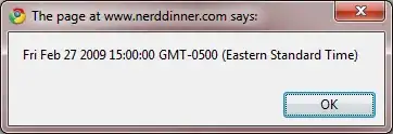

When I do an alert(new Date(1235764800000)) I get this result:
I also get a result of 8PM when I run the same query with LINQPad. Why is the time zone incorrect in the JSON result? It seems to assume that the response is in GMT. Should I handle this on the client (via javascript) or is this something that I can set on the server?
