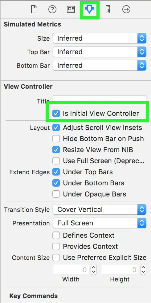

If you still want to work with the storyboard then what you have to do is upon creating the project set the 'User Interface' to 'Storyboard':
