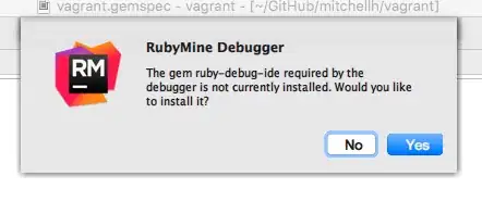

Then I go to Debug and I see this pop-up:
If I select yes there is a status dialog that appears to be trying to install these:
.../ruby-debug-base19x-0.11.31.gem
.../ruby-debug-ide-0.6.1-beta2.gem
After which RubyMine displays this error:
Error running Vagrant Up:
Cannot start debugger. Gem 'ruby-debug-ide' isn't installed or its executable script 'rdebug-ide' doesn't exist
If I try to debug again it just runs me through the same popup-install-then-error loop.
