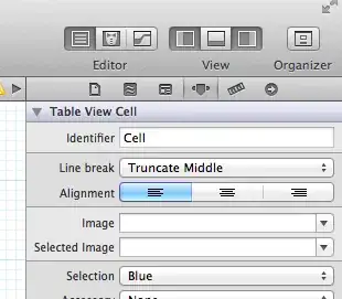

These are the constraints I have for the UIImageView:
