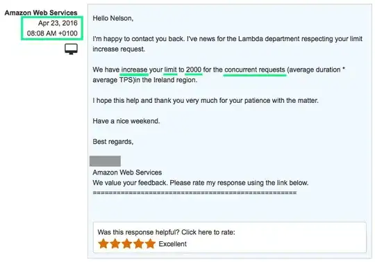

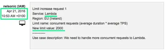

The solution was to open a support ticket providing the following info:
Limit increase request 1
Service: Lambda
Region: EU (Ireland)
Limit name: concurrent requests (average duration * average TPS)
New limit value: 2000
And then in the body of the ticket/request try to estimate your usage pattern:
Expected average requests per second: 200
Expected peak requests per second: 2000
Expected function duration: 2 seconds
Function memory size: 1000mb
Invocation Type: Request-response
Event Source: Api Gateway & Lambda<->Lambda
It can take a while to get a response from AWS Support unless you are paying for premium support, so its best to load test your app during development/staging and request to increase concurrent invocations before you launch your app!
In our case it took 45 hours from initial support request to get the invocation limit increase.
The AWS support people are lovely, it just took what felt like ages (almost two days!) to get the service level increase, which would have been fatal if our launch had been public!
