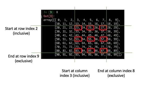

Step 1 - Obtain subset
Specify the "start index" and "end index" in both row-wise and column-wise directions.
In code:
In [5]: X2 = X[2:9,3:8]
In [6]: X2
Out[6]:
array([[23, 24, 25, 26, 27],
[33, 34, 35, 36, 37],
[43, 44, 45, 46, 47],
[53, 54, 55, 56, 57],
[63, 64, 65, 66, 67],
[73, 74, 75, 76, 77],
[83, 84, 85, 86, 87]])
Notice now we've just obtained our subset, with the use of simple start and end indexing technique. Next up, how to do that "jumping"... (read on!)

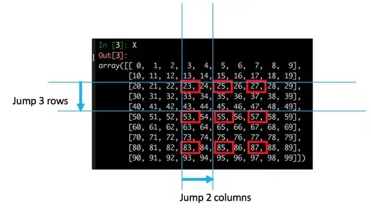

Step 2 - Select elements (with the "jump step" argument)
We can now specify the "jump steps" in both row-wise and column-wise directions (to select elements in a "jumping" way) like this:
In code (note the double colons):
In [7]: X3 = X2[::3, ::2]
In [8]: X3
Out[8]:
array([[23, 25, 27],
[53, 55, 57],
[83, 85, 87]])
We have just selected all the elements as required! :)
