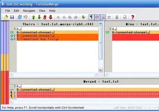

The part of the problem is that B (unwated change) is included in .merge-right and I can't tell the difference between which revision it came from. I usually use TortoiseMerge and here's how it looks.
