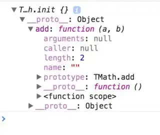

Therefore, the created object (in this case test) has a property __proto__ that points to the TMath.init.prototype.
And you can confirm all this by doing the following:
console.log(test.__proto__ === TMath.init.prototype) // true
console.log(test.__proto__ === TMath.prototype) // true
Conclusion
Indeed what you originally thought is correct
If I console.log out test.\_\_proto\_\_, I get Object{}.
Shouldn't I get TMath.Init.prototype, since that's the function constructor my test instance was created with?
