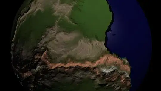

Here's a screenshot of my normal cubemap applied to an icosphere:
The tangents for my cubemapped icosphere are generated with the following code. m_indices in an std::vector of indices into the std::vector of vertices in m_vertices.

As far as I can tell:
- My tangents are being calculated correctly.
- My normal map looks like a normal map to me.
- I'm changing my light and view direction to tangent space to match my normal map.
The result is nothing. I.e. nothing is drawn to the screen. Not a solid color at all. So like everything behind is drawn with no occlusion.
If I discard the lookup into my normal map, and instead just use the tangent matrix light and view I get the following:
There's a post-processing lens flare on this that's producing those funny bits and bobs. What's important I think is the overwhelming glare from the surface where the normals seems somewhat accurate.
If I then just transform the light by the tangent matrix I get this:
All of this combines to tell me I have no idea where I'm going wrong.
I have an inkling that it's my tangent generation because the other pieces seem to follow what every tutorial I've read appear to say. The tangents are generated with a cubemapped icosphere in mind. So to determine the <S,T> or <U,V> 2D coordinates from a cubemaps usual 3D coordinates, I:

So, with that out of the way, I can now see my colours come through. With my nice sexy bump mapping.
However, there's now a problem at the seams of the cubemap. I'm not sure if it's because of the tangents being calculated or because of the way my normal map is generated. My normal map is generated from a height map for each face, independently.
This would explain some seam affect I think, I'm going to modify it to sample the adjacent face on those edges and see what happens.
I still think that the tangents being generated are also going to have an adverse affect on these seams as well. My thoughts is that they are going to be pointing in opposite directions at the seams.
Screenshot:
EDIT 4 While testing from EDIT1 down I was using a very very low poly mesh for my icosphere. So I had minimal sub-divisions.
I wanted to see how my not quite perfect normal mapped sphere looked with lots of polys. This instantly revealed this problem:
In case it's not clear, running from left to write is my old friend, the seam, but below that are, what appears to be, triangle edges.
So after all of the above, I think I'm back to my original problem of incorrect tangents.
Still looking for some help from anyone that's reading this.
EDIT 4 Well, that was quick. This site here http://www.geeks3d.com/20130122/normal-mapping-without-precomputed-tangent-space-vectors/ gave me another way to create tangents. Whilst the code seems somewhat similar to what I was doing on the CPU, it's not resulting in those randomly oriented tangents that was producing those edges from EDIT 3.
I am very close now. I still have the seams, this other method of generating the tangents seems to have increased their "seaminess"

So I'm now sort of "bleeding" into the adjacent cubeface to sample the height there while generating the normalmap. This has actually increased the seam appearance.
But this sort of raises it's own questions. For instance... "why in the hell is the affect increased?" You can see that it's now a sort of bevel effect.
So, I'm fairly sure I've matched up my cubefaces correctly when "bleeding" into the next one. This brings me back to the tangents being incorrect.
Even if I completely mixed up the cube faces, it wouldn't give a bevel effect, it would be something completely spotty. For example, even on a completely flat section, i.e., bleeding the normal map generation into the next face would have zero effect, I still see a massive bevel.
This makes me think that if the tangents were correct before, the normal map sort of "matched" the tangent directions? I don't know.
quick edit I noticed that I was effectively sampling my face edges twice during my original map generation. If I remove this double sampling and just use 0 for the additional, I end up seeing those same big seams. I'm not sure what this means...
Another quick edit
This image shows something that I think is very telling.
I can see here that two different faces are "pointing" in opposite directions. This is with my in fragment tangent generation.
So I'm back to my tangents being a problem.
