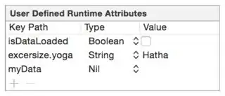

We now have a "Border Color" property available via the Attributes Inspector which isn't ordinarily there. The reason I point this tool out is because whenever you set one of these properties via the Attributes Inspector, the value you set is actually stored as one of these "User Defined Runtime Attributes":
And whenever this view is loaded from the XIB in my app, one of the first things that will happen is that my borderColor property will be set to this red color I've selected in the Interface Builder.
