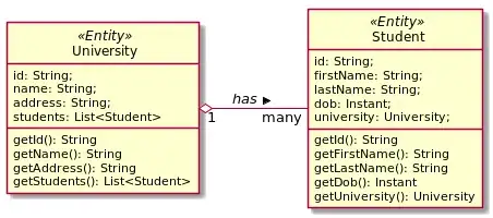

Sometimes you have two entities and there's a relationship between them. For example, you might have an entity called University and another entity called Student and a University might have many Students:
The University entity might have some basic properties such as id, name, address, etc. as well as a collection property called students that returns the list of students for a given university:
public class University {
private String id;
private String name;
private String address;
private List<Student> students;
// setters and getters
Now when you load a University from the database, JPA loads its id, name, and address fields for you. But you have two options for how students should be loaded:
- To load it together with the rest of the fields (i.e. eagerly), or
- To load it on-demand (i.e. lazily) when you call the university's
getStudents()method.
When a university has many students it is not efficient to load all of its students together with it, especially when they are not needed and in suchlike cases you can declare that you want students to be loaded when they are actually needed. This is called lazy loading.

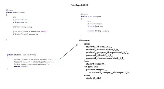

The main difference between the two types of fetching is a moment when data gets loaded into a memory.
I have attached 2 photos to help you understand this.

Check the retrieve() method of Main.java. When we get Subject, then its collection listBooks, annotated with @OneToMany, will be loaded lazily. But, on the other hand, Books related association of collection subject, annotated with @ManyToOne, loads eargerly (by [default][1] for @ManyToOne, fetchType=EAGER). We can change the behaviour by placing fetchType.EAGER on @OneToMany Subject.java or fetchType.LAZY on @ManyToOne in Books.java.
The best way to understand the difference between these is if you understand lazy-okay. FetchType.LAZY tells hibernate to only fetch related entities from the database when you use the relationship.
P.S: In many projects I have worked on, I have seen that many software developers do not pay attention to them, and there are even those who call themselves senior.If the project you're working on isn't data-exchanging on large volumes of data, it's okay to have EAGER here. However, considering the problems where n+1 problems may occur, you need to pay attention to these after you know the fetch types of the relations by default.
Here you can see the default values: Default fetch type for one-to-one, many-to-one and one-to-many in Hibernate
Also, it doesn't end there, even after understanding fetching types. To understand when to use LAZY and when to use EAGER, you also need to understand the concepts of unidirectional and bidirectional. Also, the spring boot repository has some methods that allow it to read data for you lazy or eager.For example, the getOne() or getById() methods allow you to lazy fetch data from entities.In short, what you use and when depends on what the other party wants you to do.

LAZY: It fetches the child entities lazily i.e at the time of fetching parent entity it just fetches proxy(created by cglib or any other utility) of the child entities and when you access any property of child entity then it is actually fetched by hibernate.
EAGER: it fetches the child entities along with parent.
For better understanding go to Jboss documentation or you can use hibernate.show_sql=true for your app and check the queries issued by the hibernate.
