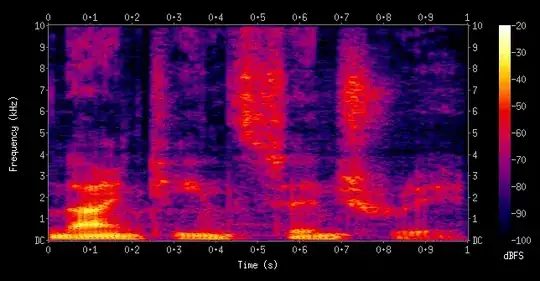

The spectrogram is a 2D visual heat map where the horizontal axis represents the time of the signal and the vertical axis represents the frequency axis. What is visualized is an image where darker colours means that for a particular time point and a particular frequency, the lower in magnitude the frequency component is, the darker the colour. Similarly, the higher in magnitude the frequency component is, the lighter the colour.
Here's one perfect example of a spectrogram:
Source: Wikipedia
Therefore, for each time point, we see a distribution of frequency components. Think of each column as the frequency decomposition of a chunk centred at this time point. For each column, we see a varying spectrum of colours. The darker the colour is, the lower the magnitude component at that frequency is and vice-versa.
