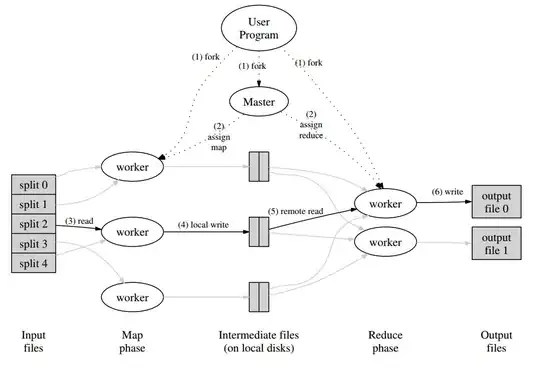

Let's take the example from the Google paper. The goal of MapReduce is to be able to use efficiently a load of processing units working in parallels for some kind of algorithms. The exemple is the following: you want to extract all the words and their count in a set of documents.
Typical implementation:
for each document
for each word in the document
get the counter associated to the word for the document
increment that counter
end for
end for
MapReduce implementation:
Map phase (input: document key, document)
emit an event with the word as the key and the value "1"
end for
Reduce phase (input: key (a word), an iterator going through the emitted values)
for each value in the iterator
sum up the value in a counter
end for
Around that, you'll have a master program which will partition the set of documents in "splits" which will be handled in parallel for the Map phase. The emitted values are written by the worker in a buffer specific to the worker. The master program then delegates other workers to perform the Reduce phase as soon as it is notified that the buffer is ready to be handled.
Every worker output (being a Map or a Reduce worker) is in fact a file stored on the distributed file system (GFS for Google) or in the distributed database for CouchDB.

A little more depth on the paper:
MapReduce was originally mentioned in a Google paper (Dean & Ghemawat, 2004 – link here) as a solution to make computations in Big Data using a parallel approach and commodity-computer clusters. In contrast to Hadoop, that is written in Java, the Google’s framework is written in C++. The document describes how a parallel framework would behave using the Map and Reduce functions from functional programming over large data sets.
In this solution there would be two main steps – called Map and Reduce –, with an optional step between the first and the second – called Combine. The Map step would run first, do computations in the input key-value pair and generate a new output key-value. One must keep in mind that the format of the input key-value pairs does not need to necessarily match the output format pair. The Reduce step would assemble all values of the same key, performing other computations over it. As a result, this last step would output key-value pairs. One of the most trivial applications of MapReduce is to implement word counts.
The pseudo-code for this application, is given bellow:
map(String key, String value):
// key: document name
// value: document contents
for each word w in value:
EmitIntermediate(w, “1”);
reduce(String key, Iterator values):
// key: a word
// values: a list of counts
int result = 0;
for each v in values:
result += ParseInt(v);
Emit(AsString(result));
As one can notice, the map reads all the words in a record (in this case a record can be a line) and emits the word as a key and the number 1 as a value. Later on, the reduce will group all values of the same key. Let’s give an example: imagine that the word ‘house’ appears three times in the record. The input of the reducer would be [house,[1,1,1]]. In the reducer, it will sum all the values for the key house and give as an output the following key value: [house,[3]].
Here’s an image of how this would look like in a MapReduce framework:
