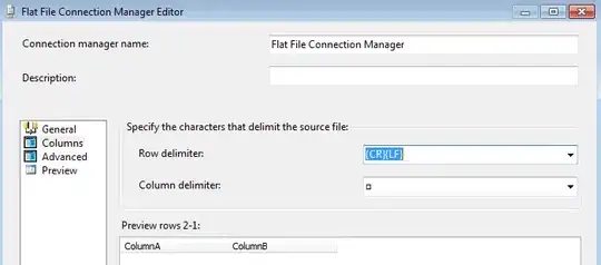

I haven't fully tested this, but it seems doable.
Create a template flat file with the headings. I used Linqpad to create the Ctrl-A character using a unicode string (\u0001). You could also get there the ascii route using \x01 (same character, just pointing this out if you need to use it in code). Here's what's in my flat file.
ColumnA□ColumnBCreate a Flat File Destination, and create a New Flat File Connection. Select Delimited as the type.
- Browse to your flat file template, check the Unicode box (if unicode), and if the data should contain headers, check that box too.
- Copy the Ctrl-A character from your template and paste it into the Column delimiter box. Then click the Refresh button.
You should now be able to work with the delimited columns. If you need to manually recreate that character in code, you can always use \x01 or \u0001.
