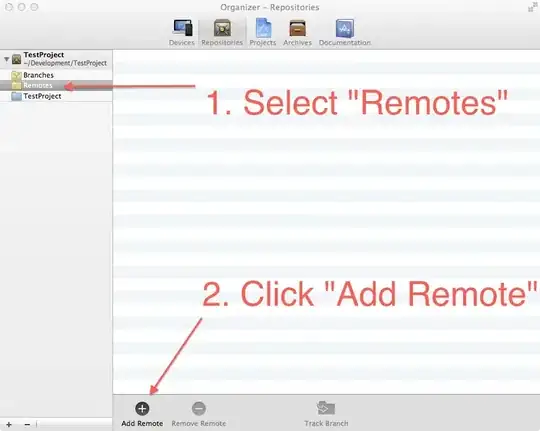

think I found the Xcode way to push a existing project to GitHub or any other remote repository!
Preconditions
I assume that you have a project created by Xcode 4 with a local git repository. You created an empty remote git repository (I call it RemoteRepository in in the following example)
Push it to remote
- Open the Organizer in Xcode an go to the Repositories tab
- At first click on Remotes and then on "Add Remote"
- Enter a Remote Name and the Location of your remote repository and click on create
- Then select your project and open File -> Source Control -> Push ...
- Select your remote repository and wait until it is connectable! Look for the Create in the brackets.
- Now your old project is published to GitHub
