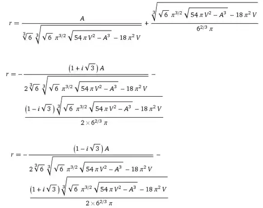

So, discarding negative radicands is not the best solution because you still might rule out valid real solutions, since the radicands in the second term could cancel out the imaginary part from the first term. Additionally, the 2nd and 3rd roots have i in their formula, so you are sort of forced to deal with complex numbers there. These roots should also never be thrown out, because even for cubics with 3 real roots, 2 of the 3 roots are still calculated using complex numbers!
Dealing with complex numbers is something that
- JavaScript does not handle natively, and
- is non-trivial enough that you would not want to implement it yourself. That's where. math.js comes in.
Read here to learn about math.js. But for this question, you just need to know about one method. math.js does its work through its math object, and the method we are concerned with is math.eval(expr,scope) which will evaluate a string expression expr and use the variable assignments specified in scope.
So, initially looking at the 3 roots provided by wolfram:
They are a little bit unwieldy. Upon closer inspection, they all have a common term:
That term is an expression of A and V, so lets move that to a function of A and V, called f
So substitute that term for our new function f, and now the roots are a lot more manageable:

So now, lets test it out. Using the values from the link you provided, say the radius r is 2, and the height h is 1.5
Then, the volume V=pi*r^2 is approximately 18.85, and the surface area A=2pi*r(r+h) is approximately 43.982. Using the methods defined above, we can get the roots.
Note that result is the result of evaluating r^3 + A/(-2*pi)*r + V/pi using the given root, so if the result is 0, the root was calculated correctly. Actual values will be accurate to about ~15 digits due to round off error.

And this agrees with the roots provided by wolfram alpha.
{-3,1.00005,1.99995}
