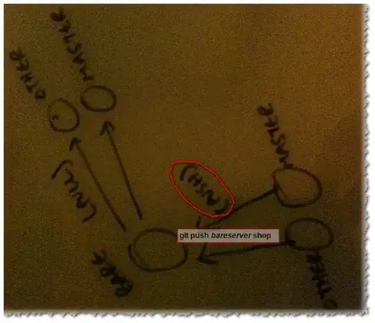

From your diagram, it looks like what you have done is:
- push to the bare (from local)
- and then, from remote, register bare repo, and pull from bare
"From my local root: git push bareserver shop"
