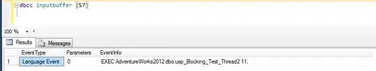

First thing I did was run a CHECKDB and CHECKTABLE, but neither of these returned an issue with the table. So we decided to rebuild the table. I rebuilt the table by hand, then copied the data over from the original table to the new table. I believe I used a sql tool for this, but I may have run an insert into. (It’s been a while and I didn’t document.) Either way, it didn’t work. The organization continued to experience blocking. So then I re-indexed the table, and that seemed to work, for about a day, and then the error “came back.” Since then I found INPUTBUFFER, which I was running on the SPID of the blocking user every time for a while. Almost every time, the INPUTBUFFER would return a SELECT statement, though I don’t think that’s what was throwing the block. I don’t think the SELECT was throwing the block because in the Access GUI what happens is you hit the save button, it runs a save or update, then it runs a select to refresh the Access screen. I would think that if the SELECT was throwing the block that the save would have happened, but when recalling the record after the process starts blocking, and the process is killed, the user changes are never saved to the record. I’m not entirely sure how INPUTBUFFER works. I know it supposedly returns the last statement sent to SQL Server, but if the save didn’t commit, could Access still be sending SQL to SQL Server?
