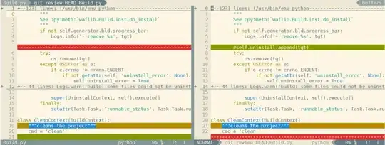

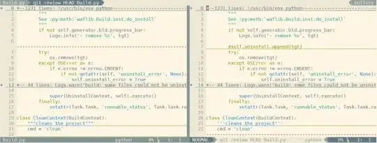

The reason is that the default vimdiff color scheme assigns DiffChange bg as "LightMagenta", which gets mapped to a very light pink in 256 colors. That is unreadable with white text. With 16 colors, the "LightMagenta" is mapped to a bold magenta, which white text shows up much better on.

256-color screenshot
16-color screenshot
As you can see, the 16 colors is much more readable, without changing the color scheme.
