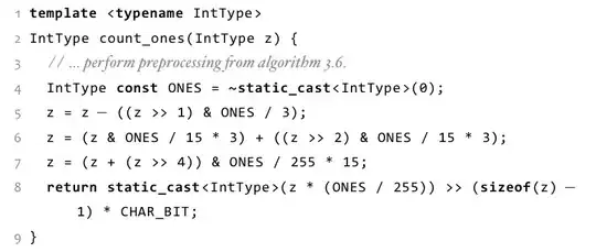

As an example, here’s a source code typeset with listings which shows some of the things that a replacement should also provide:
[“Sideways addition” modified from Bit Twiddling Hacks]
