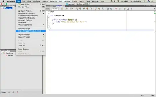

Netbeans IDE 8.2 (OSX)
Goto File -> Project Properties (Your Project)
Select Formatting in Categories:
Click on Edit global options.
Then Click on Ok
- Uncheck : Expand tabs to space.
- Click on : Apply
- Click On : Ok
If you want set project specific then :
- Select : Use project specific options.
- You can also select Language (PHP)
Then Click on Ok
