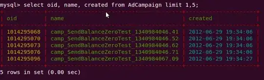

I've spent much time trying to solve that question. It took me nearly a year to solve it :) There is nice option in mysql config called "pager".
I've just published my configs for mysql client and grc (availiable in most nix dists). Check it out on github! https://github.com/nitso/colour-mysql-console

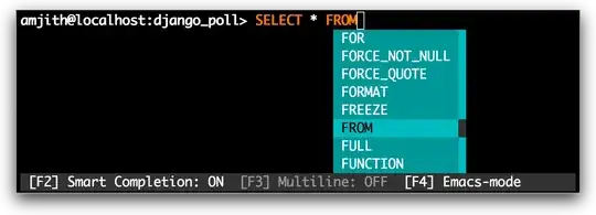

Here is pretty much awesome tool https://github.com/dbcli/mycli
Besides syntax highlight it offers completion.

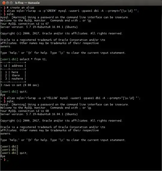

You could use rlwrap if you just want a colour prompt:
% rlwrap --prompt-colour='1;34' mysql
Note: contrary to convention, rlwrap spells colour with a U.

It seems you have to do: `rlwrap -a -p'RED' mysql` to get it working properly. Without the -a the prompt doesn't get coloured. – Neil Jul 07 '10 at 17:31

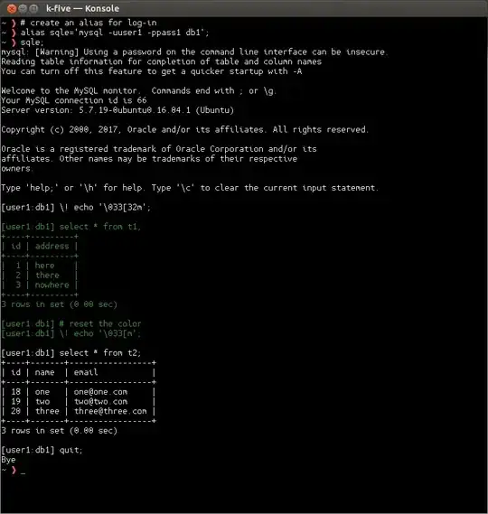

For colorizing everything you need nothing but a simple echo.
Since mysql has:
system (\!) Execute a system shell command.
you can easily:
