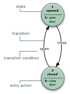

This state machine from the Wikipedia page:
http://en.wikipedia.org/wiki/File:Finite_state_machine_example_with_comments.svg
