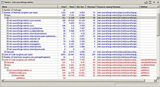

I want to know how many methods an interface declares or a class/enum implements. How to get that in Eclipse?
Asked
Active
Viewed 4,595 times
1 Answers

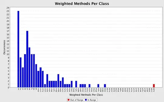

A plugin like metrics could give you that:
The eclipse-metrics plugin (another one) provided also a similar metric (Weighted Methods per Class)
